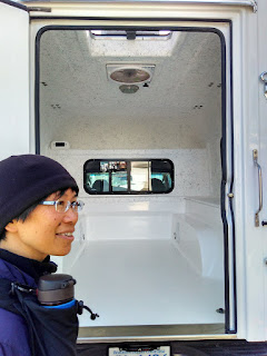

I’m particularly happy about the Bomar boat hatch/skylight and the Maxxair Fan. I did a lot of research before I decided on these two modifications. I chose the Bomar because Bomar sold the biggest boat hatch I could find in Canada. Light is very important to me. I’ve fantasized about skylights for years. I wanted a Heki RV skylight, but it had to be ordered from Europe and they can leak. I chose the Maxxair because it’s possible to install a hood over it so it can be open in the rain, very important to reduce condensation in wet weather. I live in the Pacific Northwest.
Photos below: Above my head in the left corner in the photo below is another modification, a combination 12V socket and dual USB ports for recharging electronics and computers. Ahead of the fan is a light fixture for which I will buy an LED bulb, they use 1/10th the power of an incandescent.

Tufport did a great job, but one major disappointment was that the windows were not where I specified. I wanted 2 1/2  feet of space on the wall between the end of the camper and the window so that I could build a counter and storage of that width there. There is only 2 feet! I have to rejig my plans.

    Hi Ming,the quality is obviously there and that unit will last the rest of your life, unless you get “2 footitis”. Will you use teak/mahogany and build it out like a sailboat?
    What is the interior height?

      I am using regular SPF (spruce, pine, fir – cheap wood) for the bed and shelves for now as I have a tight deadline for the December trip. I want to see how I use the space before I make the final design.
      The interior height is 5 feet, perfect for me as that is my height too, I just have to tilt my head a little. It is a good compromise, as 6 feet would make my rig taller than I’d like for COG in tilted roads and for low hanging branches on logging roads.

      It turns out that they thought a forward placement of the windows would weaken the structure too much, once it was time to install them. I’m ok with that reason, rather than thinking that they just forgot our discussion!
